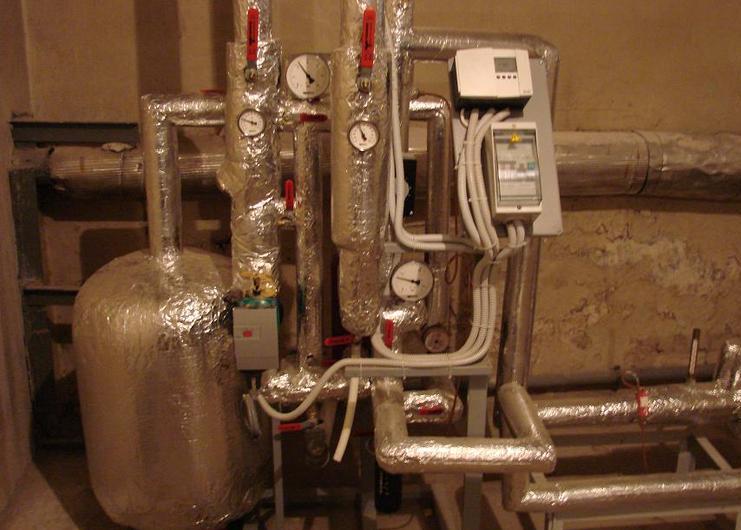

Kodune akupaak ja pioneerist tulevad torud.Akupaagile 50mm võrguvill ja tollistele torudele 30mm seinaga villakoorik+0,5m alumiinimumplekk.
http://img692.imageshack.us/img692/2833/pb130016i.jpg
http://img208.imageshack.us/img208/7665/pb140021.jpg
http://img577.imageshack.us/img577/4342/pc160083.jpg
http://img534.imageshack.us/img534/124/pb130013d.jpg
