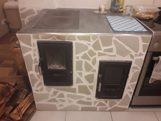

https://cache.osta.ee/iv2/auctions/1_1_16472714.jpg Kena pilt.
