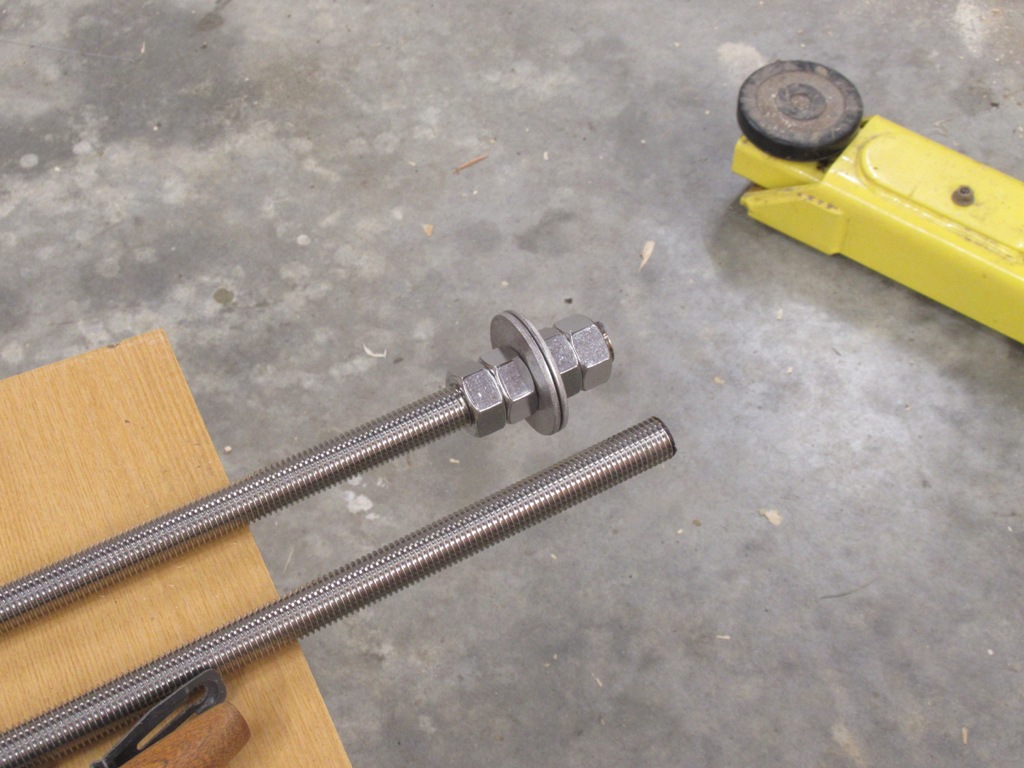

Ma panin igaks juhuks mutreid topelt ja keerasin mutrid omavahel veel korralikult kinni.

Korrektne oleks vist panna mutter ja see kinni keevitada. Kuna ma keevitada aga ei oska ja masinat ka pole, tuleb vist midagi sarnast arendadaT25 kirjutas: 28 Jaan 2025, 22:33 Kui keermelati kasuks otsustad, siis ära unusta betooni sisse minevale otsale ankurdamiseks vajalik seibist ja mutritest "punn" kokku keerata:

Eng-tips-ist:
Seib on ehk isegi ülearune. Panna lihtsalt kaks mutrit ja omavahel kinni keerata.Welding to an anchor bolt is usually a terrible idea, though some have special compositional properties that make it feasible (dual certification as A36, or the Supplement 2 for F1554 Gr. 55). Many of them undergo various forms of heat treatment, and welding can undo that treatment and weaken the bolt.
A washer isn't really needed. A standard washer is so thin that it's very flexible compared with the nut below it and concrete around it. By the time the assembly has moved enough to mobilize the resistance of the thin washer, your anchor is already on it's way out of the block of concrete.
Kunagi, kui ma siin foorumis veel ei käinud, siis oma peaga leiutades sai keermelatti soojendatud ja L kujuliseks väänatud. Ilge jama võrreldes mutri variandiga. Pealegi L kujuks väänatud ankur on mutriga variandist palju nõrgem.
